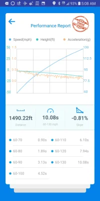

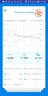

Set a few new forum records today.
11.66 1/4 at 119.71
7.56 1/8th at 95.13
0-60 7.73
Not records, but also hit my first 120 mph trap and did a 10.08 60-130 for the roll racers.
Changes are 23 lb wheels and midpipe (secondary cat delete). Most the gains were from the wheels. Before and after 0-60 testing showed 0 gain for the pipes.
Temp was 31 degrees and 300 foot elevation.
Screenshot_2019-02-26-05-17-05.webp Screenshot_2019-02-26-04-58-13.webp Screenshot_2019-02-26-05-08-39.webp
11.66 1/4 at 119.71
7.56 1/8th at 95.13
0-60 7.73
View attachment 20428 View attachment 20429 View attachment 20430

Congrats! Looks like the lighter rims were worth around 1mph for you too.
Looks like I caught up on @Terry@BMS 60-130 roll time. I ran a 10.08 on a 11.68 1/4 vs his 10.05. I didn't go to 130 on my 11.66 run.
I also had about .2% less slope.
I got my dragy random slope issues fixed. There was a fan viewing over pass ;) on the old track that seemed to whack out the dragy slope. With out the over pass the slope was very consistent.

No offense to anybody, and I mean this in the most productive way possible, but a 1.85 60ft (Tonkabob's last run) is absolutely terrible. Nothing against Tonka / Tork / etc, it's just where the platform is at right now. When trapping ~120mph I feel like we should be cutting 1.6s with ease. I had a big turbo Audi A4 ~15 years ago which ran 12.7 @ 110 and even that thing cut a 1.7 60ft.
I really hope there is progress on anti-lag soon or this platform may never be taken seriously for 1/4 mile performance
Completely agree, like i keep saying back-end flash is the next big thing for this platform.
I am running an ecu tune but the launch is still near stock. Tork is working on that. My typical LC launch is at 0 psi and 2350 to 2455 rpm. Throttle doesn't fully open until 12 mph.
