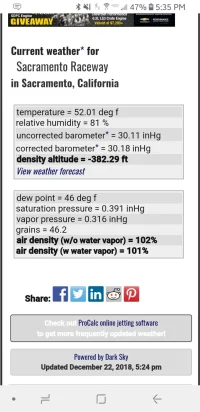

One of the most important variables (and what I think you're trying to say) to an ET is DA (density altitude) which NEEDS to be factored in. If I live in Atlanta and run an 11.9 with a current calculated DA of 54 feet, I am NOT going to run the same time in July when the calculated DA in Atlanta is 3522 feet.
My DA's that day.
