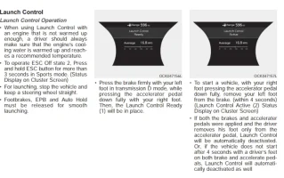

How do you engage launch control?
Traction and stability control off hit the brakes and gas.

Has anyone tried to setup custom mode with sports mode for engine and transmission, then "launching" via brake torqing? Does this activate launch control? If not, this might be a good way to spool up those turbos for a harder off the line launch.
yes, It does activate LC
I also tried in comfort mode with brake torquing it and it doesn't go into LC but still limits it to 2K
You can do that in Sport if you dont disable stability control. Revs to around 1700 rather than 2100. Not fast.
I did a 1/4 mile run in comfort by accident and it was .4 slower.
While using autohold in sport and no power brake is only .03 slower.
