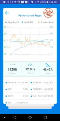

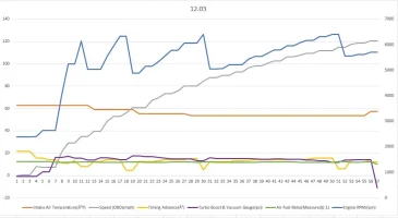

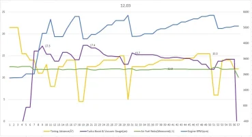

Got some new improved dragy times ill post shortly when i have my pretty graph logs ready. The new track has no turns and no up hill. Both the hill and turn was slowing me down. Down slope is between .33 and .99 %. Did a slow run and 3 fast ones and slope starting from the exact same spot (a post) was .35, .42, .92, .99. So dragy isn't the best at elevation.
New Stinger and new Stinger AWD dragy record. 11.95 @ 117.4.
The log is for my 12.03 run I ran just prior. Turned the car off and the app didn't reconnect for the 11.95 run.
According to phone altitude the slope was -.7% almost splitting the difference of dragys .-35 and .-99%
Tork tune, JT intake, catback, ultimate FMIC. Have all 4 cats and on pump 92 octane.

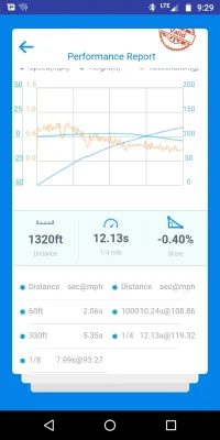

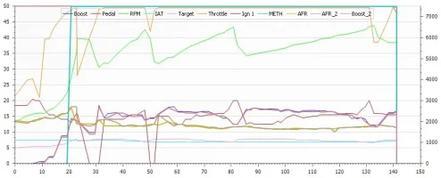

Was a little less humid out tonight so hit the private track for a few runs. Same mods as last time, JB4, BMS intake, BMS WMI kit (50/50 meth mix), 91 octane, drag radials. This time I added a can of Lucas octane booster. So more like 93 octane. And cranked timing up a bit with a JB4 firmware change.
Still couldn't get a good launch, but very happy with trap. :)
