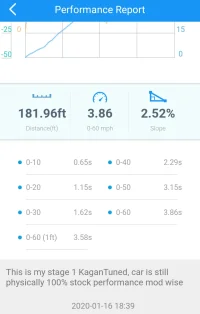

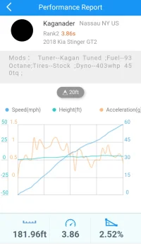

From the Dragy leaderboard; sub 4 seconds to 60, apparently with tune only, no mods....
View attachment 36823 View attachment 36824
No all his runs are without LC and he is still completely stock.Kaganader Tuning on Instagram: “For all the nay sayers that do not believe how fast the stinger is for the verified 0-60mph. As you can see there is no physical…” He’s just a very experienced tuner and knows how to maximize power and results.He had to have changed something related to launch mode... No other G70 or Stingers that I know of are hitting those same 0-60 times while everything else is stock, even putting down more WHP and WTQ than him.
When I talked to him he said he was only changing fuel, ignition timing, boost, and throttle mapping. Maybe he's dug deeper now?

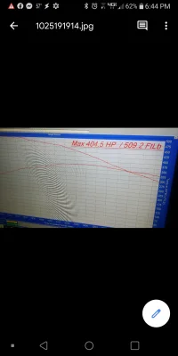

I'm assuming that was for me, lol. I don't know.... I'm not looking for boost in the 20's.. I usually max at 18psi now. I'm gapped at .024 and would like to stay there or .025ish is ok. If I see something that will protect major components I'll check it out. My Dyno was on E30 map 5 Dyno Dynamics AWD and was 404 who, but would kickdown before we could get to max (GT2) and 509 wtq.....nice flat torque lineWhy not?
Dyno sheet?
