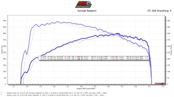

I had my ultimate performance high flow cat downpipe combos installed, Dyno before and after, yes they were a pain to install, about 12 hours total including fixing broken stud, they are awesome love the sounddynorunShare_0.webp
I see now what Torq motors meant by not a lot of HP gain for the cost and pain of install
Yeah he wasn't far off with his numbers, I didn't do it for just horsepower and torque gains alone, really just wanted to loud pipes and free flowing exhaust which is exactly what I got
I had my ultimate performance high flow cat downpipe combos installed, Dyno before and after, yes they were a pain to install, about 12 hours total including fixing broken stud, they are awesome love the soundView attachment 50313
Did you happen to reset your ecu by unplugging the battery? Our ecu is a notoriously slow learner, I wonder if you would have gotten better results with an ecu reset or by waiting a few weeks before getting back on the dyno.
No I did not reset the ECU nor did I ask if it was reset during the repair, the work was done by Modified by KC, they're basically the only one around with a all-wheel drive dyno, they did not charge any extra for repairing the notorious broken stud on the turbo, I definitely recommend this shop to anyone,, I do agree my borla exhaust started sounding better and better as time went on, with these pipes and borla Cat-Back this thing is loud
