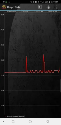

I just went for a drive with a Bluetooth OBD2 adapter hooked up transmitting data to my phone through the Torque app. I found the 2 smoothest, flattest roads I could find around here and monitored throttle position with CC engaged at 55mph then again at 75mph. Every time I felt the surge I would make sure to watch the throttle reading. At 55mph it jumped up by about 2% every time. At 75mph it was much more apparent and jumped by 4% every time the surge was felt from 24% to 28% or even 29% sometimes. For what reason? I dunno, I'm not a tuner, but if I can find data like this with an $11 adapter and 20 minutes of time, let's hope KIA can do the same and fix the logic.

I took a screen shot of a line graph I recorded on my app to show the tech at my dealership what the throttle is doing so he doesn't think I'm crazy when we go for a ride and figured I'd share it here as well. It can be worse than this, but this was just a quick one I snapped so he gets the idea..

Just left the dealership. The "Stinger tech" test drove my car and then I went on a drive with my SA. The tech said he didn't feel the surge. SA said he felt it a little under certain conditions however I can specifically tell you they never recorded any data which I specifically asked them to do. My SA was helpful, though, in telling me he will talk to other owners to see if they have experienced the same thing and told me to continue graphing my throttle conditions. After I get a few good instances, email him the graphs so he can start a tech bulletin with Kia Motors and show them the info I have been finding. So.. Not much progress
