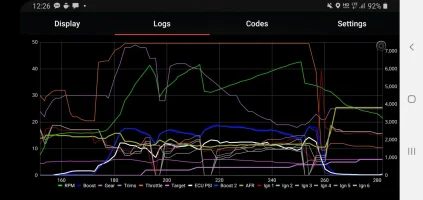

It is a better log.
Your timings are not very good.
I get similar timings when I use bad fuel.
I would suggest to stick to map2 or use more octane booster, but let's wait for Terry's verdict.

I'll use more Octane booster and see where that gets me, what should I be looking for from my timings?
They are all over the place and at low values.
I usually this happens when the fuel is bad or when the ECU hasnt adapted to the new fuel.

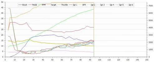

I find it helpful to also do a log in 3rd gear, go about 15mph, then floor it (but don't kickdown), all the way up until redline, then let off the throttle.
This gives you more resolution with your logs, and is helpful for really looking at AFR's and ignition timing.
Either way, I agree with @xot1, your ignition timing looks like it's varying a little too much, though, it could be much worse. Overall values are a little bit low, but not bad. I'm not seeing big drops other than shift points (which is normal). 1st and 2nd gear look fine, but 3rd gear your getting a couple cylinders losing a few degrees of timing as the rpms climb. It's not too bad though.

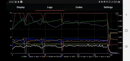

As a comparison these are good and stable timings:

Only pressing gas pedal half way but log itself seems solid to me. Some minor timing drops but nothing major.
Looks beautiful!! I wonder if you got that Mishimoto IC kit, if it would help you keep a tiny bit more boost up top...
I don't think it would.
The boost dropping with RPM is the stock ECU logic.
