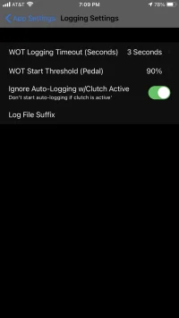

What are your "log" settings? i had the same issue when my log settings were set below a certain %
What should my settings be.

Really not a "should be"....depends upon what you want the results to be......My app would crash at different points. i disabled the "ignore auto logging....." and set threshold to above 50% and was able to get more stable results....emailed support but most suggestions i had already tried. Also, make sure no other Bluetooth devices are present and the jb4 adapter is away from metal and close as possible to the cabin.

YIKES!!!! That basically says the unit is a "dud".......once i made the adjustments to the logging parameters, my issues stopped. Not sure why "logging" had an effect but that is what cleared my issues up.
