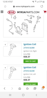

Thx. One more quick question if you don’t mind pls. Are coil packs cylinder specific or could a guy buy a spare that could replace anyone that may be faulty? Sailing back ground....we carry spares for freakin everything. Thx you’re a star. Cheers:)
They are universal
It looks like ignition coils have different part numbers. Right & left
I stand corrected then. Thought they were all the same.
Maybe that could be Scott's problem if installer got them mixed up.
This is funny because I was on the Hyundai/ Kia parts site last night they are having a sale. Ordering JB4 soon though I would get a coil to have for spare just in case when I noticed they were different Right to Left.
I'll try to pop one off the left and right later this week to compare them. Maybe the difference is just the mounting bolt alignment?
My guess is mounting bolt.. In general, they should be swappable in the electronic sense - otherwise, you'd have to have special coding or hardware for ONE coil pack.. That would be weird..
