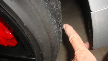

I had this exact same issue with my 2018 Premium. I chased after a solution for over a year and might have found the root cause. I say "might" because I traded the car for a 2019 GT1 just over a month ago and didn't want to spend any more money on something that may or may not have been the root cause. Summarizing heavily, the theory was that the sound was caused by the wheels being out of alignment from day one. Driving with the wheels out of alignment caused the tires to develop "feathering" which made the noise worse, especially at the speeds you mentioned. I got an alignment done but didn't spend the money on tires prior to trading it in. I know others have mentioned they replaced the tires and still had the issue, but I don't know of anyone that has checked their alignment AND replaced the tires.
About the other Stinger in inventory making the same noises, I've had also noticed that when shopping around for a 2019. I test drove a 2019 Premium, and three different 2019 GT1's before buying. Of the four Stingers I drove, two of them made the noise. It was more subtle than on my 2018 with feathering tires, but I literally turned the car around whilst on the test drives saying "nope!" I ended up buying one of the GT1's that didn't seem to make the noise at all, at least initially. After a few hundred miles, I started to notice it but it was extremely subtle. I had a local tire place check the alignment (I have trust issues with local Kia service departments...a whole 'nother story) and surely it was out of slightly out of alignment. Since having the alignment corrected, I don't hear the noise. I didn't drive the car out of alignment long enough for the tires to feather, so this lends some credence to the theory that the alignment is the primary issue.
All this said, I don't really know if it's just an alignment issue...just a theory. Anyone else with the issue that has recently had their alignment and tire condition checked should be able to debunk this for us.
I think there is something to this theory. Alignment would be the most common cause of uneven, "feathering" tread wear. But my car is not out of alignment. My FL tire's outer edge wore down quicker than the rest of the tread; and the FR tire was fine. The reason for the outer edge wearing faster would be the way I drive: as often as I made use of a certain cloverleaf, I would "spiritedly" try for the maximum corning speed. Obviously, the FL tire gets the brunt of this. The Tail of the Dragon finished the tire off; but I didn't know this all the way home.
C. 1,800 miles more to get home; and I had the car in for oil and filter change and all points inspection; they swapped my wheels over because I forgot to tell them not to; then the tech took a tread depth reading of the "FL" tire (which he declared "fine" at 5mm in the center), which was actually the FR now in the wrong position - because I don't swap the TSW "Watkins" directional wheels; when I discovered this mistake, I had the wheels put back on the correct side by my wheel guys: and it was they who told me that I had "feathering" on the outer edge of my FL tire. This is what I saw:

On the road trip, I had been noticing a faint "thrumming" sound that hadn't been there before. This is most likely the culprit. Since getting new PS 4S on the front the sound has apparently gone away.
