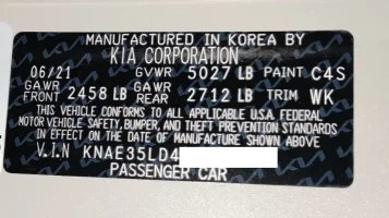

I had time to search and located Kia (TSB) Technical Service Bulletin service action for grip handle repair.
"Longer screws", that is it? No mention of the screw "cups" that press into the ends of the shafts having pulled out. What failed then? How would longer screws fix this? None of the normal length screws have been a problem before or after this production run period. Or, maybe KIA went to longer screws going forward?
