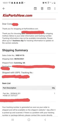

BTW, if anyone still has this problem with the IC hose that connects to the drivers side intercooler with the weird clamp, I found just the clamp without having to purchase the whole assembly. I got just the IC inlet hose I needed for $84.14 plus shipping and handling, for a total of $113. Still a lot for one hose but cheaper than buying the entire hot side turbo piping assembly which is closer to $450 to $500.
I found it on KiaPartsNow.com
