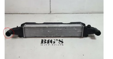

Anyone that has taken off the intercooler? Have you ran into issues removing this clamp? It a weird clamp and I beleive I am getting a boost leak from it. Any thoughts?
Weird how?

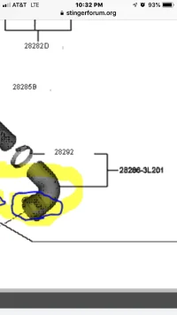

I dont know if you taken the intercooler off and personally seen the pipe i circled on the picture, but it is not an ordinary clamp where you loosen. Its like a plastic clip with some type of pressure wires that hold it together. I was not able to take it it off, I had to remove the silicone from the other side of the pipe to remove the whole piece together. I tried to look online for picture of it but could not find one. The piece is worth $550 dollars from kia. Today while i was driving i realized that i am not building boost. I think the clamp is damaged or something is going on.

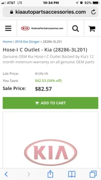

I see the part for like $80 from any of the many online Kia parts suppliers
You sure you are searching the correct part number? Can you provide the link?
282723L222
282723L222
Looking at the screenshot you provided and highlighted...and the part # shown... your part # above is for the entire assembly. Not just the 1 hose/clamp.
28286-3L201

That passenger side connection is actually quite nice. It uses a lip seal. Just a clip to hold it in place. No clamps. PITA to attach an aftermarket hose to that side of the IC, but it's actually a great idea. But they're more expensive, hence they didn't use more of them.

Yeah I don’t know if I really like the idea lol I like just the old fashion way and use normal ic clamps. After inspecting the connection it does look nice and seems to be very functional but very suspect that it can leak. That clamp with the hose it’s $550 dollars from Kia. I will stick with a 3 dollar clamp. But found some interesting things when I took the car apart.

Angel, I posted above. The $500+ is for like every hose clamp part in the entire assembly. Not for that 1 hose / clamp you highlighted.

Oh ok I went off that part number. No worries my bad. Ok good to know the clamp and hose seem to be fused together.
