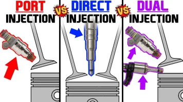

Carbon buildup on valves is a direct injection phenomenon. Port injection engines spray gas in the intake runners, upstream of the intake valves, so they're constantly being washed.
Adding charge pipe injection effectively turns our cars into a simple version of dual injection (because you won't have the capacity or logic to switch between them) I believe Ford runs just port injection at idle & low load to keep things quiet, then adds direct injection up higher, while Toyota runs both until high load/revs where it goes pure DI.
