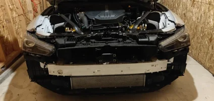

^I like the SSR, but it most likely won't work with the G70, as we have active aero flaps that are attached to the radiator shroud. It would most likely be in the way. You cannot remove them either without a way to spoof the aero mechanism.
Here is mine during my VT Snorkels install. Their kit has a G70 specific module that the servo attaches to that fools the ECU into thinking the aero flaps are still working as intended so that you can safely remove the flaps and radiator shroud without getting a check engine light.
I must've looked at your pics 20 times...(hopes of copying the method)
Will it peel off the strut tower braces? Or if you had to remove them the barrier just comes along with 'em?
Biggest issue I see for me is zero clearance b/w passenger filter and this hose
Well not biggest, that would be my lack of mechanic skill
