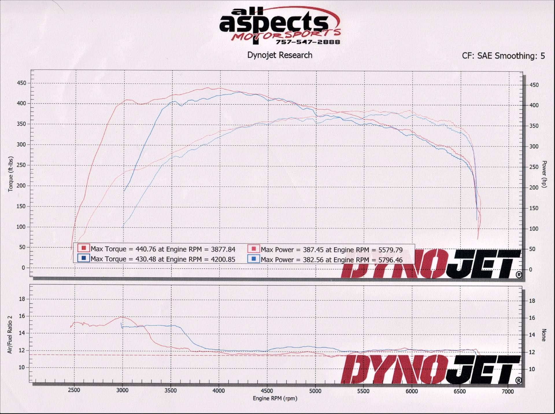

I've had the Injen on the car for a few weeks, but got around to putting her on the rollers. I felt the power and response difference, but I (and most of you) want empirical evidence. This is NOT a knock against the Stillen intake nor the Injen. They are totally different designs, and thus produce different results.
Stillen intake (red line w/ mods below) decent torque bump, modest whp gain. I suspect intake only (no other mods) would net more whp than torque.
(blue line is OEM intake w/ JB4 EWG/Fuel wires, Map 2, 93 Exxon gas, Ark secondary pipes, Stillen catback, JT merge pipe, GFB Mach 2 BPVs, Denso 5347 plugs)
Injen intake (exact same mods as above)
So, I traded torque for horsepower. I do have logs from this run, which I'll have BMS take a look at. But, everything looks fine from what I can see.

Based off those numbers (assuming they're valid), I guess if you do a lot of off-the-line runs, up to 40-50, then you want Stillen for the low-rpm torque to get you going. If you spend a lot of time in the top rpm range (1/4 mile or top speed runs), Injen is better? I.e. Stillen for the street, Injen for the track?
They're valid for my car. Every engine is different and results always vary (although not by much).
Sure, not disputing that. I just wanted to point out that I was not trying to dig into possible sources of error with the dyno run itself, just looking at the results. I could have maybe worded it better :-)

That is some good info. Really unusual to see nearly square hp and torque like that. The Stinger is typically torque heavy.

Oh, the Stillen intake has been sold, and there's no way I'd go back. Honestly, I don't feel the torque difference, but I definitely notice the a acceleration increase at higher rpms and speed (40 mph to 70 is crazy fast).
