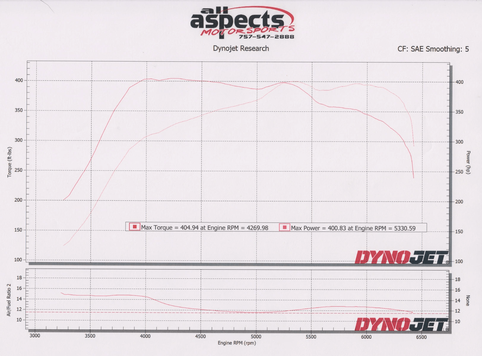

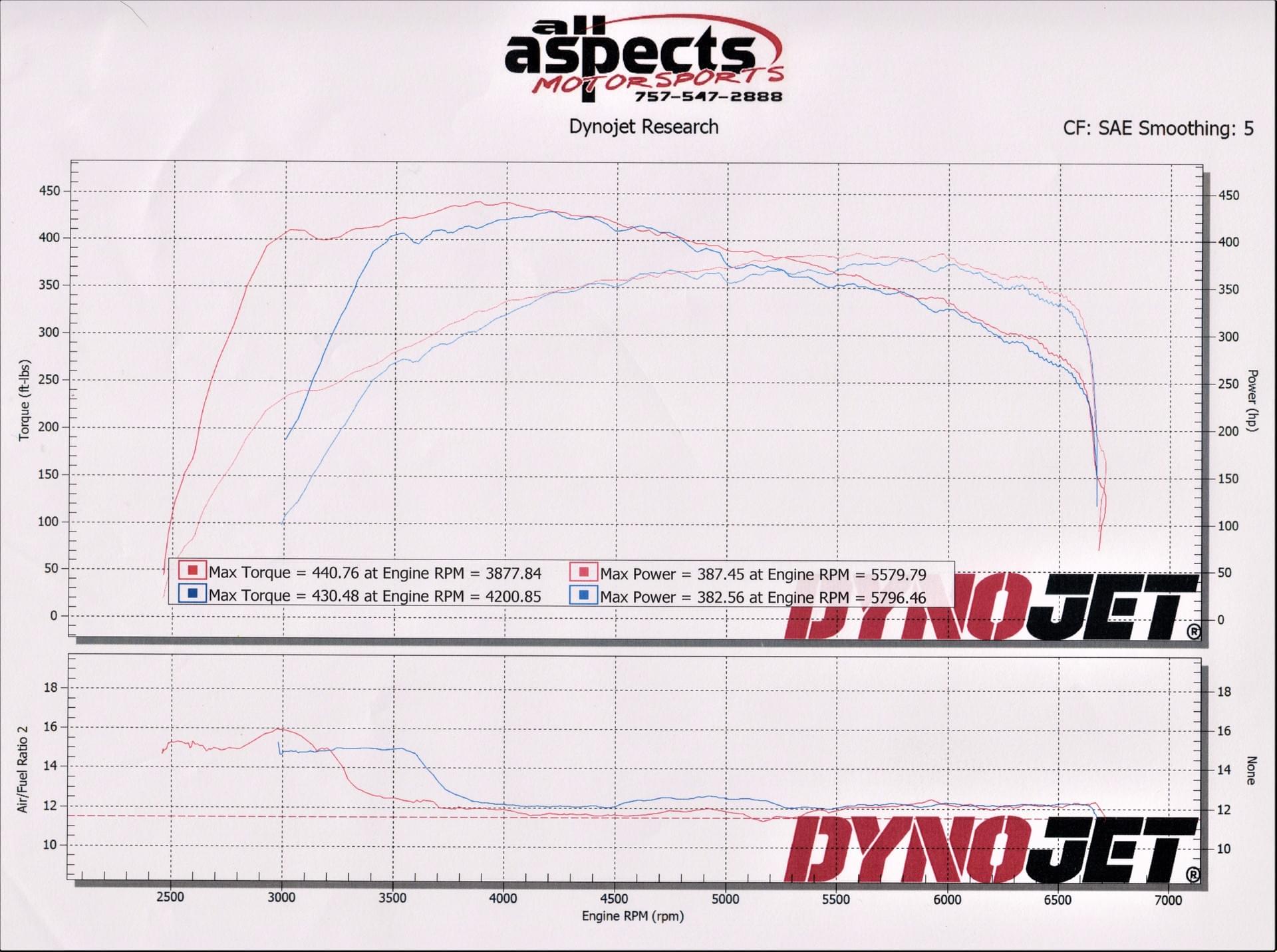

I've had the Injen on the car for a few weeks, but got around to putting her on the rollers. I felt the power and response difference, but I (and most of you) want empirical evidence. This is NOT a knock against the Stillen intake nor the Injen. They are totally different designs, and thus produce different results.
Stillen intake (red line w/ mods below) decent torque bump, modest whp gain. I suspect intake only (no other mods) would net more whp than torque.
(blue line is OEM intake w/ JB4 EWG/Fuel wires, Map 2, 93 Exxon gas, Ark secondary pipes, Stillen catback, JT merge pipe, GFB Mach 2 BPVs, Denso 5347 plugs)
Injen intake (exact same mods as above)
So, I traded torque for horsepower. I do have logs from this run, which I'll have BMS take a look at. But, everything looks fine from what I can see.

Based off those numbers (assuming they're valid), I guess if you do a lot of off-the-line runs, up to 40-50, then you want Stillen for the low-rpm torque to get you going. If you spend a lot of time in the top rpm range (1/4 mile or top speed runs), Injen is better? I.e. Stillen for the street, Injen for the track?

They're valid for my car. Every engine is different and results always vary (although not by much).

That is some good info. Really unusual to see nearly square hp and torque like that. The Stinger is typically torque heavy.
Could you post the logs or a screenshot of the logs with one point highlighted. Just curious what timing and temps looked like for all of the runs.
So I guess you stuck with the Injen intakes?
Seems as a RWD car already struggling for traction the Injen may serve me better.

Depends on if you plan to do WMI. If you do Jb4, map 2, 93 octane, the car remains very drivable in my opinion. Winter months and cooler temps of course cause issues with summer tires, but otherwise ok. Map 7 with water/meth is a whole different beast when it comes to traction. From about 35mph and up it's a beast, just have to watch it down low.
In all honesty though, just go with what you like the best. every car is different anyway.

Oh, the Stillen intake has been sold, and there's no way I'd go back. Honestly, I don't feel the torque difference, but I definitely notice the a acceleration increase at higher rpms and speed (40 mph to 70 is crazy fast).
