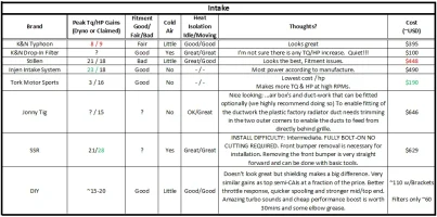

I really like this chart idea. Props on that..... Would it be too much to add a colunm for availability on 2.0T and 3.3TT? That way we can have a quick reference also? And if you want to add the BIG Mouth ram intake that just came out this month?

The peak HP gain for SSR is not accurate. Peak is closer to 15. You are showing max hp gain. All the intakes are about 15 peak and 25-30 hp max give or take. Most manufacturrers don't mention the max.
What's the difference between peak and max???
Peak is the highest hp on both charts. Max is the largest HP difference. Near redline the difference is 30 hp but that isnt the peak for either line. Total or peak only goes up 15.

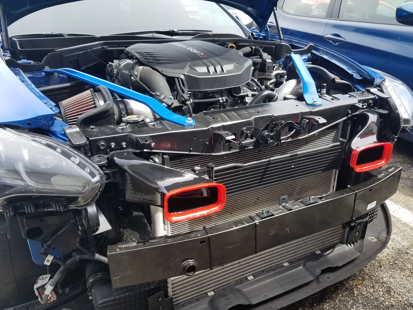

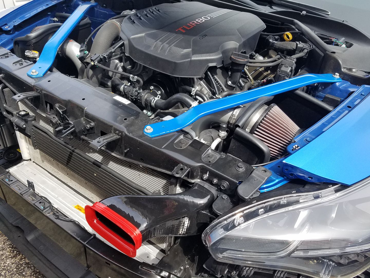

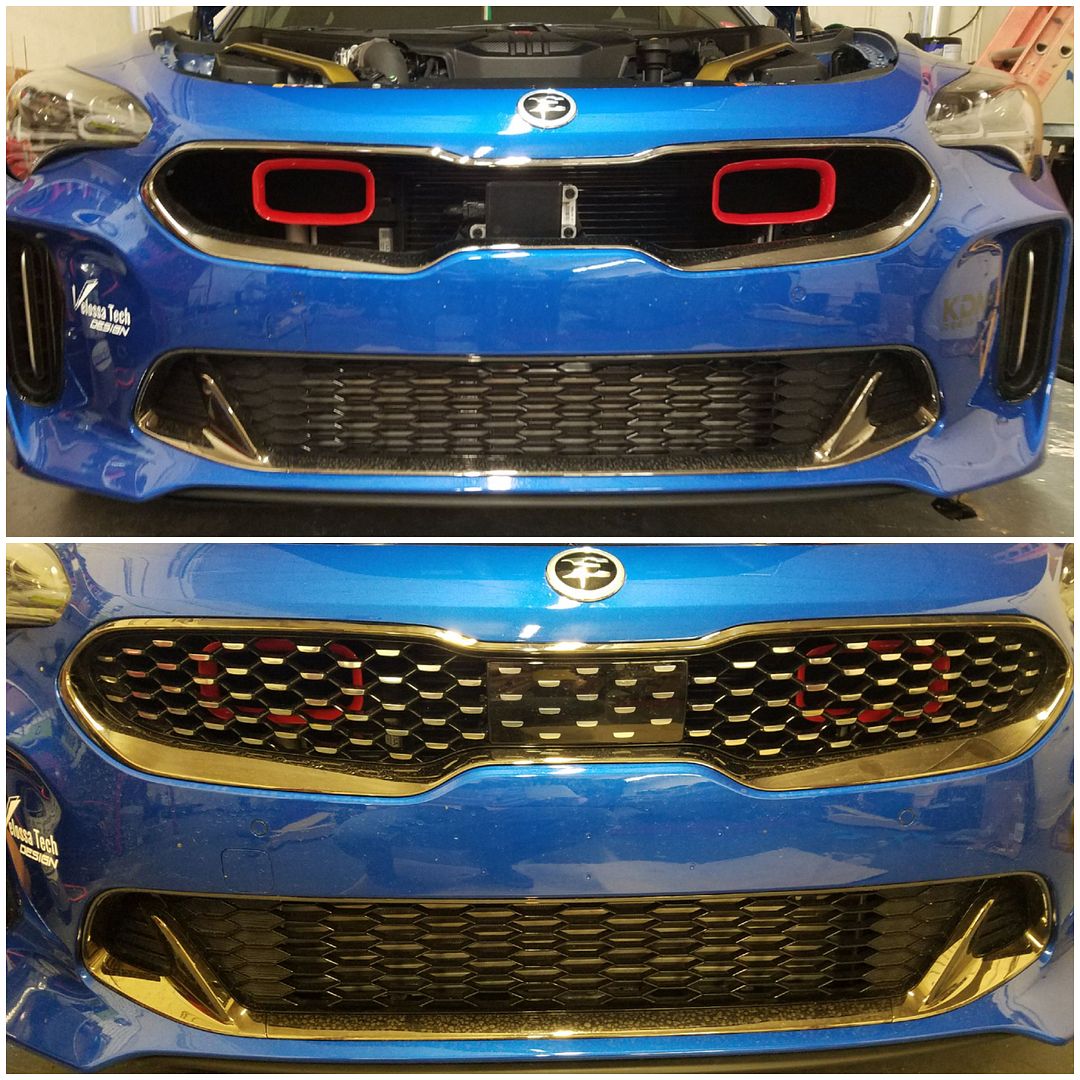

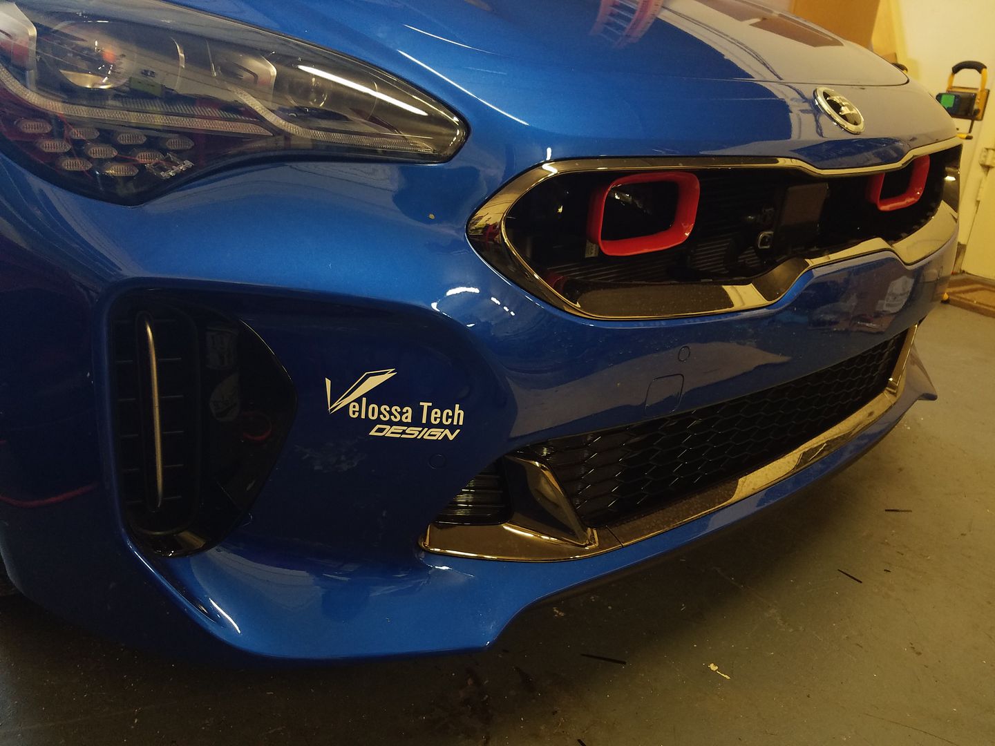

Don't forget another option is installing any cold air intake of your choice and complimenting it with our BIG MOUTH ram air intake ducts which are optimized to capture as much frontal dynamic pressure available. :)
Kia Stinger 3.3T and 2.0T - BIG MOUTH - Ram Air Intake | Velossa Tech Design

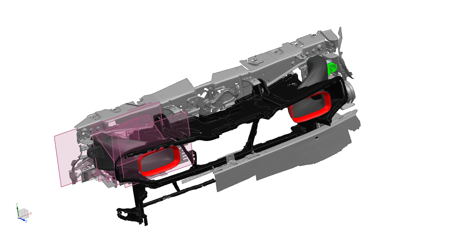

For those who want to keep it simple yet effective and go with an off the shelf cold air intake (stillen, K&N, injen etc..), our ram ducts will feed your intake (aftermarket or stock) all the air it needs and then some. Our specialty is low pressure drop ram ducting and CFD analysis and fluid optimization of our BIG MOUTH line of ram inlets.
We 3D scanned a stingers radiator support and shroud to ensure the design had OEM fitment and ease of installation with our full color instructions available as well.
Also, 28 colors to choose from to add some style to your ride!
