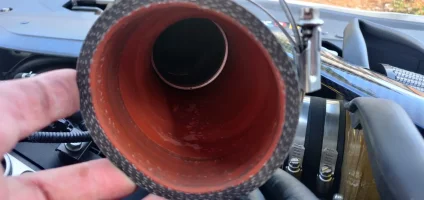

After seeing those pics and the way the orange is like glitter, I don't think that's the coupler at all, just coincidental coloring. This person might have been spraying something, you just didn't know because the pipe was swapped out or removed. If the coupler lining could produce a perfectly glittery powder to spread around like that, it might be believable, but some part of you probably knows that the lining isn't capable of creating a powder. If the lining was breaking down, you would get scattered bits of varying sizes, shapes, and thus varying weights and not such a nice "even" look. Either something was sprayed that was taking the coloring with it, or that's just the lining at all.
Makes me wonder what you've got yourself into, here, lmfao
It for sure is the coupler. I can feel the power like bits on my finger. I don't know what caused it to become like dry powder but it did.
I'm still leaning towards something dumb, like the previous owner was spraying octane booster or something lame. The pic you showed of the coupler doesn't match the end result of orange powder... The two don't look connected by anything other than color...
Well I sure know that the powder in the manifold and the powder from the coupler are the same. They feel and break apart the same. As for the octane booster, he did not use a booster. Or meth. The most logical reason I think is this: charge pipe boost sensor was busted in the crash. Car gets totaled, Copart takes it. They try to start it. It starts but runs bad due to smashed sensors. Bad stuff gets ejected from PCV entrance. Hits closed throttle and then stays there. For a month. I get the car some time later and start it up. Stuff gets blown in.
Can you scratch the coupler apart with a screw driver?

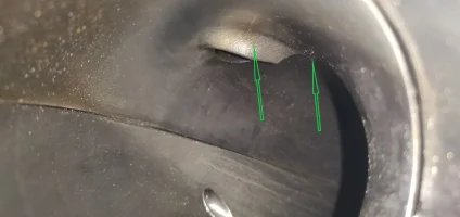

Guys.... I think this problem isn't just limited to @General_Vodka 's car. I pulled off my TB and snuck my endoscope down into the manifold. It was very difficult to angle the scope to see inside the manifold/surge tank; however, I did get a fair/mediocre picture of one of the sets of intake runners. It's difficult to tell if there are orange bits in there primarily because of the focus distance of the endoscope, but I think you can see some within the intake manifold, just proximal to the throttle body.
Take a look.
First off, the charge pipe-to-throttle body coupling looks very similar to Vodka's, as in, I'm seeing those same white-ish splash-like stains that look eerily like material breakdown...
Next up, this is looking just behind the throttle body (after it was removed), the green arrows are pointing to what looks like orange bits from the coupling...
This is a picture from my endoscope. I'm sorry for the quality, but it's very difficult to get a decent picture with it as there are too many bends and it's hard to get a good, in focus, picture because of all the angles. Anyway, this is one of the intake runner sets. Green arrow is pointing to what may be bits of orange - OR it could be just reflections from the endoscope light...
Last but no least, I was hoping to get a decent picture of some of my intake valves, but again, this was VERY difficult. This was the best picture I could get. It's difficult to see, but I think there is a little bit of carbon buildup beginning to form.
Take a look.
Take a look.

Interesting... I would agree that those two orange bits look round just like Vodka's glitter pattern. The real question now is that, you too, have evidence of splash and liquid in the coupler. The highest priority question is... WTF IS THAT LIQUID AND WHERE IS IT COMING FROM?!?! o_O:eek:

IMG_20200305_191843_0.webp Though I don't have glitter yet (checked the whole throttle body intake and all, same white stains. I assumed it was dried meth. The coupler is made of vmq (silicone) and fvmq. Fvmq is rubber. Poor abrasion resistance and not highly flex crack resistant. It is fine for oil and heat though.
educated guess here. the rubber lining does not like flexing and prone to cracking from flex. the vibration looks like its in the same stress spot on all of ours with the OP being the worst (maybe the accident did a bunch on impact)
View attachment 38945 Though I don't have glitter yet (checked the whole throttle body intake and all, same white stains. I assumed it was dried meth. The coupler is made of vmq (silicone) and fvmq. Fvmq is rubber. Poor abrasion resistance and not highly flex crack resistant. It is fine for oil and heat though.
Well, it's definitely a liquid.
I'm beginning to wonder if this is the leftover adhesive that gets heated up and melts and eventually gets puddled in the lowest pressure place of all: right before the TB where the diameter has expanded. Every dealership has said the initial chemical smell is just adhesive, and it's the only other possible liquid. Certain adhesives do have corrosive properties because that's how they bond: they microscopically melt the surface a bit. BUT, I don't think they'd use THAT kind of adhesive, lmfao
