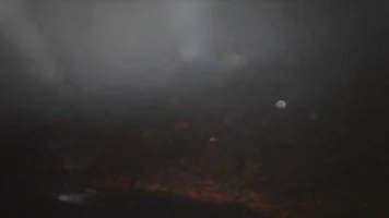

Well I don't know about you but I would rather not have rubber in my combustion. It could also serve as a pretty good base for valve carbon buildup.
Ya imma pass on my bore being smeared with rubber. Thanks though
I'm not super worried about the rubber breakdown/glitter, moreso about the carbon buildup I'm already beginning to see in my valves despite using a catch can.

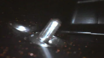

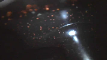

I'm wondering, those of us who are infected with the orange glitter virus (ie OGVI-20), who has used octane booster in the past?
I've used one tank full with octane booster added throughout my entire ownership of my car. I'm beginning to doubt that it's actually from the TB coupling, it's too glittery.

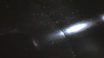

I'm pretty sure the previous owner did not use octane booster. Also tore off the orange liner today. I am pretty sure the glitter is from it. It left dry fine orange powder on my hand. Dry powder = light = gets sucked in intake easy = gets stuck on sides since they are wet with oil = become also wet and glittery due to oil. That's my logic anyways. @jeffh @Toddasaurus IMG_20200309_215955.webp

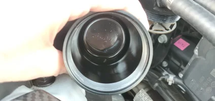

Mine is waiting for it's cleaning. I wonder if I can crank it manually to close the valves. It's in no shape to start right now lol. IMG_20200303_201427.webp
Mine is waiting for it's cleaning. I wonder if I can crank it manually to close the valves. It's in no shape to start right now lol. View attachment 39175
You can via the crank pulley. Just grab a breaker bar or something and slowly turn the pulley clockwise. As long as the tranny is in park it should spin freely.
