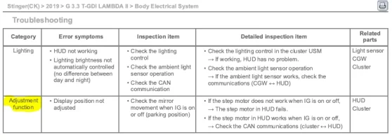

If someone has access to a service manual, it would be handy to know if the adjustable display position uses some mechanical means, or scrolls a fixed display. I always assumed the latter, but....
Per the service manual the adjustment function uses a step motor in the HUD unit
