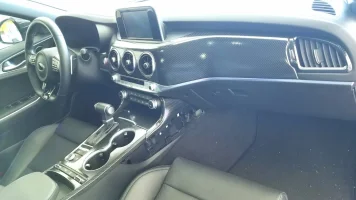

So, was able to get them off, wasnt able to get the best pics since its raining out right now, garage pics will do for now. Also used my last scrap to cover the little sections to the left of the steering column. Have more material on the way, so will do the big dash section, and think i might try the rear diffusor

You’re doing a very nice job on those pieces. I tried to wrap those rear ones with 3M wrap but couldn’t satisfy my OCD. I’m currently carbon fibre skinning a rear spoiler and the under hood plastic pieces. I think I’m starting to win, the spoiler was a bit of a learning curve but coming along now and I think I’ll be polishing out a couple of the small pieces today. I should have started on those probably would have saved me one of my failed efforts on the spoiler. Anyway great work thx for sharing.:thumbup:

So i opted to not remove and cover the gauge cluster piece. Think it might be too much straight across the whole dash. However if this doesnt hold up good during summer, ill remove it and end up doing the cluster to being some CF back to the dash. Been on a week now, no issues... yet... lol.

My OCD noticed the carbon center pieces going opposite directions..

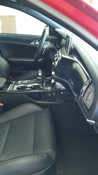

Ive taking off the middle piece of the center console and wrapped it but the other pieces of the center console are not soo easy. I havent been successful yet. I dont want to pay for the access to find out just yet. If i find out how they come off. I'll make sure to have pics. Here's a pic so far of what I've done
any luck so far because i plan on doing the same thing but with carbon fiber leather vinyl wrap
