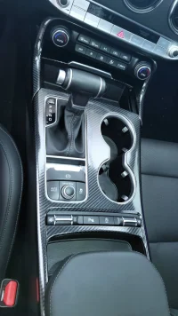

Ive taking off the middle piece of the center console and wrapped it but the other pieces of the center console are not soo easy. I havent been successful yet. I dont want to pay for the access to find out just yet. If i find out how they come off. I'll make sure to have pics. Here's a pic so far of what I've done

Which pieces are you trying to get to?
The front piece. Where the air conditioner piece is. Im half tempted to just do an inlay on it. The trim removal kit I have isnt cutting it with that air conditioner.

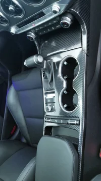

Just updating some progress and some messy pics. For the center vents , I wrapped the inside black trim piece.
What film did you use for this? It's similar to the oem CF trim I have and I think the guage cluster surround would look so much better with that treatment.
I used the interior only carbon fiber wrap from vivid.that gauge cluster is something I would like to do also. Just have to wait until it heats up more.
Does the main center console sit flush with the top part(part that eas oeiginally gloas black around the AC controls)on your after covering it? Mine seems to have a little space and doesnt sit flat. I removed as mush extra film as possible. Indont remember paying attention to it bedore i wrapped it
