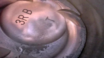

Got new Denso plugs in over the weekend, gapped to 22, same issue this morning driving to work. Back to square one!

On picture number 2 the edge of the piston doesn't look good. Excessive heat. The pistons are really clean, that's not really good. With your tuner can you add fuel? A lean condition creates lots of heat on the pistons. I hate to say this but I have seen pistons that look like that and the ring lands are usually cracked. What's oil consumption like?
Pistons look fine.
Everyone "seeing" things on the pistons, the pictures are too grainy to see any fine detail. And if you are seeing anything, it is most likely some carbon deposits. Only way to really inspect the pistons would be the pull the heads.
No consumption at all. As far as adding fuel, not sure if the JB4 can do that but I'll look into it, thanks.
Pistons look fine.

Pistons look fine.

A compression check is what is needed. As for the edge of the piston, its not too grainy to see whats up.
