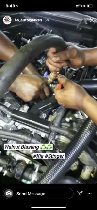

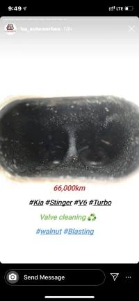

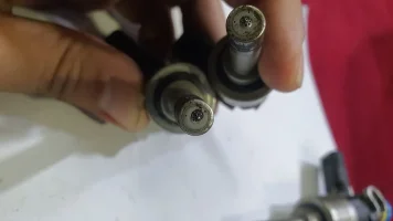

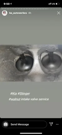

Found a local guy specializing in walnut blasting and took the car to him. Work still ongoing, should be ready tom. Pics so far attached.
Doing injector cleaning as well.

90 percent of us won’t have these cars in 5-6 years so I have to admit at 60-70000 km I’ll just trade it in and won’t even worry. My guess is these cars go160,000miles(200,000km) carefree without valve cleaning making 95% the power they did new
Not much for deposits, just an even coating. I would think you could easily double that mileage before needing to walnut blast it. Looks real nice after though!
Those valves don't look that bad, assume you have a catch can?
