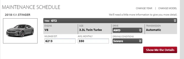

I found a few U.S. dealer sites link to this 'build your own' maintenance planner. You tell them your KIA model, mileage, trim level, normal or severe driving, etc. and it generates what services you have coming up, and what they comprise. The 'Grid' looks especially useful, and at first glance it seems to be pretty much in line with the OM maintenance schedule.
Might be handy as a planning tool ...
Kia Maintenance Schedule | Pat Peck Kia
