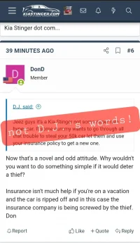

This is my first post in this thread, but @DonD your post #6 in this thread shows that I said something I did not say?
Some error or typo I assume?

Something odd here.
My profound apologies to you. I simply don't know how that happened. Sounds like a lame excuse but it isn't. We were out of town for 5 days visiting our son at Thanksgiving and the computer simply wouldn't work. Didn't take my computer with us. Took a long time to get it to function properly. Sorry, have a good weekend. Don
Lol. Its all good. Just a weird technical glitch.
