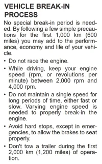

Modern engines don't need to be "broken in." In the case of the Stinger, they state "No special break-in period is needed. By following a few simple precautions for the first 1,000 km (600 miles) you may add to the performance, economy and life of your vehicle."

Well, looks like I can't edit my original post anymore, but I think we have enough data points to close this out. Of the four (current) fastest Stinger owners, three of them responded and each one had a completely different break-in procedure. One worked it hard from the start, another followed the owner's manual recommendation of intentionally keeping the RPM between 2k and 4k for the first 600 miles, and the third drove spirited, but mostly babied the car for the first 1000 miles. Yet, they all have extremely fast Stingers.
Bottom line, if you're just going for raw performance, it doesn't seem to matter how you break the engine in. That said, I personally stuck with what the manual said, and that would be my suggestion to anyone wondering what the best break-in procedure is. Especially if you're looking to keep your Stinger for the long haul. Below is a snapshot of Kia's official break-in procedure for the Stinger. This is on Page 1-6 of the manual. As you can see, Kia says their procedure "may" add to the performance, economy and life of your vehicle.
I’m sad I was not tagged =[ lol anyway if you want my opinion if you’re going to be modding your stinger and plan to go very quickly I would drive it like you stole it therefore the engine is already worn in and prepped for the mods to come. The manual states to drive it very slowly but in traditional breakin and you have a break in oil inside the engine, you want to break the engine in if you break the engine in gently , After the first oil change the brake and oil is replaced with a regular oil and you will get higher friction temperatures because the engine was not run very hard. Breaking oil is designed to literally break the engine in therefore if you’re going to use it as a daily driver with no mods then yes you can baby but if you’re going to be using it on the track you should punch it really really hard and a lot for the first 500 miles or so and then I don’t recommend going over 1000 miles with the break in oil.
No. It's right above here in @Eric Arroyo's post of the manual excerpt: 2K to 4K RPM is not "slowly". It is moderate, with RPM varied up and down within that range. The manual specifically says to not hold a single speed for extended time either fast or slow. That's it.
Obviously if you are going to push your car in competition mode, the ethic of "adding to the life of your vehicle" is secondary. To drivers like me it is top priority. I get peace of mind and satisfaction treating my material possessions with care so that they will last longer.
