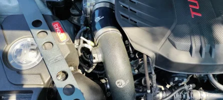

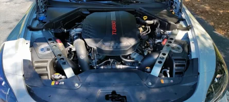

The Charge pipes are installed now and I'll be heading to the Dynojet Thursday September 22nd. So far from driving around town and doing some 3rd gear pulls, the boost delivery feels smoother. I'm wondering if I'll see any increase from my last dyno run when I was still on the factory airbox with AEM dry filters.

While my results will be different than a bone stock Stinger GT, it'll be nice to see how close I get to the advertised+25 hp, +22ft lbs. Also the kickdown switch blocker I installed a couple of days ago should help at the dyno. It took the operator a few practice runs to get used to the kickdown switch.

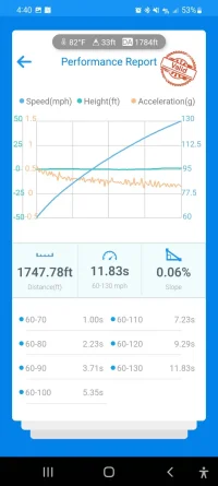

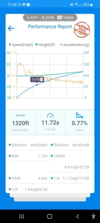

I'll be doing some before and after testing with the dragy. With these tests I plan to do a run on 93 then an E30ish mix.

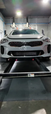

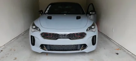

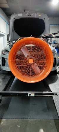

I had a very interesting day at the Dyno. We only did one run because the electric parking brake actuator on the driver side got caught on a strap and broke the sensor. Everything still works fine excluding the parking brake. (and auto hold but I never use it)
I know the guys at the Racing shop so they told me the session is on the house and they ordered the OEM part though Kia. They'll install it free of charge once it comes in. I told them it's no big deal since shit happens sometimes.
My result was 475 wheel horsepower and 448 ft-lbs. Getting a good read on the Stinger is hard because the car will auto upshift, even on the Sport drive mode with manual mode engaged. I don't park on any steep inclines so the car will be good until the part comes in early next week.
