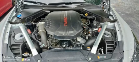

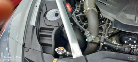

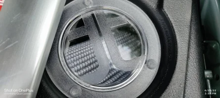

Here are my first impressions.
The fitment is perfect and the quality is top-notch. I left the optional air plugs in for a true cold air intake system. While on a short mostly highway drive, I couldn't hear any induction noise but I had the windows rolled up. I'm sure with the windows down I'll hear it. I could actually hear the stock airbox plus AEM filter combo through my ram air ducts with the windows down before. So I reckon the induction noise is pretty noticeable from the outside.
Update: The intakes are loud outside of the car, especially if you have ram air ducts. People will hear your car sucking in the atmosphere lol. So, sound check passed in my book.
Still not a CAI. Until the filter elements are moved out of the engine bay, no matter what the shielding or box design is, it's not technically a cold air intake.
Good review, though! Would love to see dyno plots compared to stock or your last setup.
Thanks for the clarification. I plan on heading back to the dyno after about 2 weeks.
The AFE seals to the pass-thru on the core support just like the stock air boxes, so all the air is pulled from in front of the core support. And it's a real box like the stock boxes, not just a shield like most options.
So, yes, it is a true CAI.
Location of the filter doesn't specifically matter. The paths the air can take to get into the intake track is what matters.
Unless you're also saying the stock setup is not a CAI, in which case I'd also argue that the ... uh... whatever brand that was that hung the filters out in the bumper cover - I'd say that also isn't a CAI because the intake tubing runs around the engine bay where it'll warm up.
