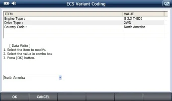

I’ve found that the Stinger suspension computer does not have the G70 program stored on it.
Each vehicle has its own computer for that system. We could possibly swap a G70 computer into a Stinger, but the results would probably be less than optimal. The G70 has a different wheelbase, spring rate, and compression/rebound valving on the shocks. The suspension computer only varies/controls rebound damping, so all of the other parameters would probably be mismatched for a harmonic ride, if a G70 computer were swapped in. To use the G70 suspension computer, it would be best to use at least the electronics shocks from the G70 too. For that expense, coilovers or lowering springs may be a better deal and result.
I’m gonna have to get some seat time in a G70 to see just how good it is...
Wait, you have access to the info on the Stinger's computer? I'm curious to know how that looks and see if that is something that once can find adjustments to change for the shocks.
That would be awesome if we could enable Sport+ mode which I think has a firmer setting on the suspension?
Yes. I have looked around inside the Stingers Electronic Controlled Suspension Computer and the Electronic Power Steering Settings too.
All of the global Stinger programs are stored in ECS computer. This means every Stinger is equipped, with the same software all around the world.
What makes different markets and trim levels perform differently is “variant coding”. Variant coding, tells the computer which of its stored tuning maps to use for your particular vehicle.
The ECS has several options.
1. Engine Type - 2.0T, 2.2D, or 3.3T
2. Drive Type - 2WD, or 4WD
3. Country Code - North America, Korea, Europe, Russia, or Australia
You select the combo you want to use and then code it to the car. Then your car uses that particular program.
Easy as pie... EXCEPT, none of the scan tools I have found properly code the stinger, and always result in a “Communication Error.”
My first scanner was an Autel Ms808. I can see all of the options but any coding failed. I sent that back and got a G Scan2. It does the same thing... communication error. I was hopeful that the G scan2 would work, because it is a product of git.auto (the manufacturer of the Kia/Hyundai OEM dealer service scan tool).
Anyway. I’ll keep working on it. Eventually an new update to the scan tools will come along that will enable them to fully communicate with the Stingers new systems.
I am pretty sure the Kia dealer could change the settings too, if the could be persuaded to do so.
But yeah, all of the settings are right there.

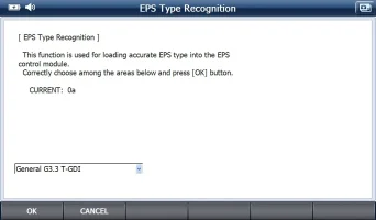

This is what it looks like inside of the Electronic Power Steering menu.

Nice! I figure the dealers could do this change but they likely won’t. It would be useful if there was a few more settings in there that would allow for tuning the damping rate of the shocks, to allow for a different setting than what it is now. Would be good to be able to change the settings for different countries and see how they feel or mix them up a bit. Thanks for the info on this! Hoping you can find some way to make some changes with this.
The Setting for Australia interests me most at this point... Aussie reviewers report that the ride is controlled in comfort mode and very firm in Sport mode. Several Australians have commented that Sport mode is so stiff that it is best reserved for the track. They do have stiffer springs and anti roll bars too, but still the additional shock valving would be nice to try.
I’ll find a scan tool that can enable this sooner or later...
The dealerships have been altering Sonata EPS settings for a while, according to the Sonata/Optima forums.
This is the same thing, but for the ECS. I will definitely keep everyone posted on my progress with this.
