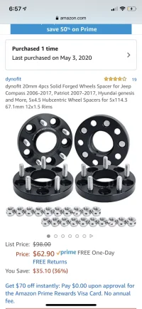

I also have spacers that I ordered off amazon ($70). I wanted to see what the fitment was with 20mm spacers. But after install I can’t get rid of a small vibration in the steering wheel around 72-78mph. So I’m probably going to order a legit set of eibach spacers or what’s available on the Khartuner store, and see if that resolves the problem. Here’s what I was trying out
I was looking at those... some else has them and reported no issue. Did you install all 4??
Yea I put them all on, I got the tires balanced last week, the shop said my front tires are at about 6/32 tread depth, maybe it’s the tires? I honestly don’t know
With spacers, its not something I'd ever buy off Amazon tbh. 1) When installing spacers, they need to be Hub-centric specifically designed for your make and model. I just ordered the H&R Lowering Springs as well from ebay -2, as well as H&R Kia Stinger GT1 22mm Wheel Spacers. I've provided a link of where i purchased (on backorder btw), but you can see a big difference just by pictures in quality of the product. You shouldn't have vibrations in the wheel is the spacers are of good quality and installed properly. Just my .02, but when it comes to spacers, you need to pay for high quality stuff.

We're talking Spacers here correct? I'm only putting name brand hub-centric spacers on my car that I know are made from high quality material and products and are made specifically for my make and model. In this case that would be Eibach or H&R. Khartunerz even has the NGT ones, although I like the H&R ones better. Anything that my wheel is being mounted too you better believe i'm going to pay for high quality/safety.
Amazon is great for that other stuff, but wheel spacers, ill pass.
