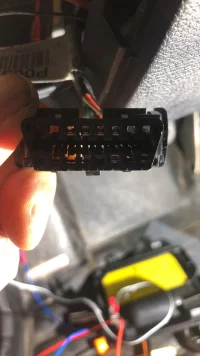

Pictures and video courtesy of FB member Eric D.
It is highly recommended to remove the negative terminal from your battery before you start.
1. Follow steps 5-7 from this link to remove the cowl trim(Right of dead pedal)
2. Follow steps in this link to remove lower crash pad(Fuse Box Area)
2a. if you do not want to remove this panel, order micro2 add-a-circuit(I bought one from local auto parts store) & 18-22awg ring terminal.
3. Tab into power and ground according to installation doc. Power should be gray wire, ground should be black.
3a. If you opted to go with option 2a, remove a constant 12v fuse(Power Lock fuse) and tap in. Use the ring terminal on ground wire to ground it to frame screw.

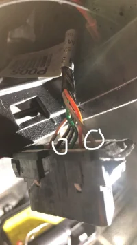

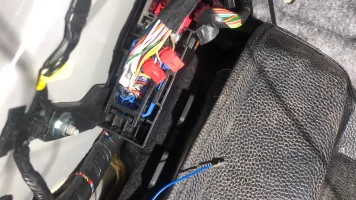

4. Refer to your install doc to locate blue MF11 connector. Remove the black cover to gain access to wires. Red wire from module connects to the top and blue wire on the bottom.
5. Reconnect the negative on the battery.
6. There should be 2 led's lit on the module. Test functionality.
7. Install trim back in reverse order and done!
Make sure your "Welcome" setting is enabled in dash for this to function properly.

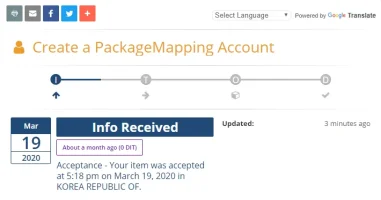

I think you are the last person that have not received it yet.
