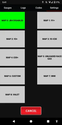

Thanks bud. One more question, as far as what maps can be run. Does burger send you info with what maps require which octane etc etc
Yep, they will also be on the bluetooth. Get the jb4 app as well which is about 30 bucks. (highly recommended)
Itll show which octane level is used for each map. Logs, adjusting settings etc.
