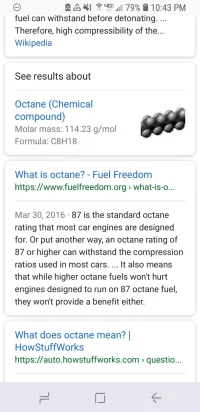

    The fuel doesn't change, the ability of it to combust changes with altitude. It's another mathematical formula.
    • Like Like x 1
