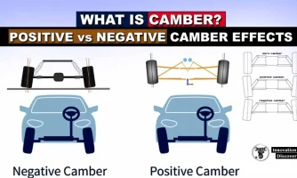

Actually the wheel is rotated outboard along the Z axis. In car design grids, the "Z" axis is up/down, so the right wheel is rotated outward along the green line.
Are you saying your camber is off on 1 side only?
No, what I'm saying is the whole wheel "appears" to be turned outward, like if someone turned the steering wheel to the right but the left wheel stayed stationary. It could be negative camber too but it will be checked next week.
