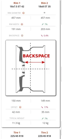

Just for fun, I compared my steel 18x7.5 ET42 to your 18x8 ET 35. Backspace is within 1mm.
We both have 225/45 tires.
Virtually identical - so I really suspect something is wrong with your numbers (wrong rims?)
Thank you. This is something I can go to Tire Rack with; have them compare the backspace (didn't know the technical term) of the OEM rims to the Sport Tuning AT4. If there's a difference then they should be able to recommend either the correct hub-centric spacer or maybe a new rim. Either way they didn't give me good advice.
