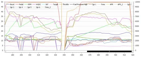

First Log check
Similar to myself, your fuel looks to be a little too soft for map2
Are use the website from Facebook found that my fuel was an issue.
I ran yours through his diagnostic and this is what I got back:

Thanks for the info, so according to the data my 93 octane gas is not good enough for map 2?
Could be a bad tank, I literally had a bad tank yesterday and my logs were brutal, prior to that they were decent. Try a different station on the next fill, maybe add some octane boost, and check again is all I can say
I have to advise, I have very basic log reading skills, only relaying info made available and offering my opinion.
I will say this log looks much better. Mild timing issues....might be left over fuel mixing with new

I'll make a minor observation. Your ignition curve on 3 and 5 are way off on your first run compared to the rest. On the second, it looks just like 5 but it's still there. Were your plugs swapped and or regapped? I'm not the best at reading them but I'm pretty sure those variances aren't normal.
Looks generally OK to me, a few timing drops. What fuel are you using?
Have only used 93, went to a different station on the second set of logs, and yes I’ve swapped plugs for the hks
OK I'd keep it on map2 with the current fuel.
I would update your software/Firmware to 21\19\5 also, I think your running 16. Its always best to have the latest
As far as firmware goes what’s the best version to go with, I ended up just flashing the stable version 30 mins ago seemed the same to me
19 fixed a few minor bugs for me, Terry himself recommended it. Specifically the option to change maps from the wiper switch, but I'm sure there were tons of other improvements.
I'd double the boostane mix and relog map3.
