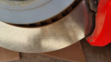

This is what it looked like at the end of the day. The brakes got plenty toasty, enough to disintegrate the plastic hub-centric rings that TireRack included with the Enkei TFRs. Lesson learned there. All 4 rotors had that nice even color sheen that's indicative of the proper kind of micro-layer pad material transfer track-prepped brakes should look like - for optimum brake performance and rotor life.
