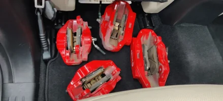

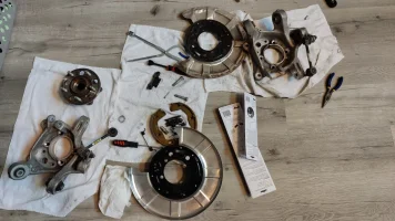

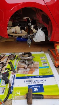

So, when I signed up for a Track Dat at Motorsport Ranch at Cresson last year, I did my due diligence to look for a worthy replacement pad. Having had excellent experience with EBC sintered HH pads on many of my motorcycles over the years, I was a bit partial to the brand. So I chose their Bluestuff "super-sport and Track Day" pad.
Being the cheapskate that I am, and the rotors still in excellent shape with no grooving or measurable tapering, I just scrubbed off the pad material deposit and slapped on the Bluestuff.
As I was just finishing up the initial "breaking in" or seating the pad to the rotor, and starting in on stage 1 bedding in, the rear was nice and smooth, but the front started to vibrate a bit. Yeah, sometimes the Scrooge does get caught for being cheap. No biggie, I took off the front rotors and had them turned at O'Reily's for $25 a rotor. Back on they went.
O'Reily's did an excellent job and only shaved less than 0.2mm off each surface. I'm still far from the minimum rotor thickness (F 28.0mm R 20.4mm).
As expected, the front brakes complained no more, and I repeated the seating process for another 100 miles or so of really easy driving/braking. Then did my stage 1 bedding in, per EBC instructions. I decided to wait for the actual track session to do Stage 2 bedding in, because trying to do it on public road was just not practical, or safe. All there was left to prep was bleed/flush with high-temp DOT4 fluid.

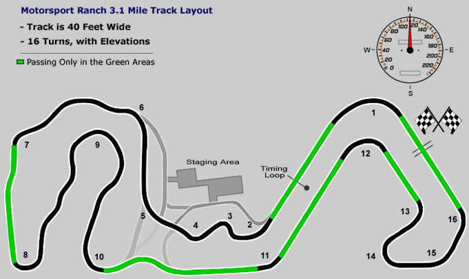

So Track Day came, and I took it easy for the first session, mainly to memorized all 16 turns of the long 3.1mile course, which at my age took a while. Just as well, it gave the pad and rotor time to really know each other, consummately their marriage, and bed in (pun intended) properly.
For the other three 20-min sessions, Bluestuff performed brilliantly - zero fade, linear pedal feel, and ample braking power that's easy to modulate.

questions: how far into ownership were you when you put the brembos on? how expensive was that?
I bought the '19 base 2.0T around the end of 2020, when dealerships were just coming out of the Pandemic lockdown full of inventory and were practically giving them away. It was too good a deal to pass up on. As I was working the deal, I already found a set of almost brand new Brembos on ebay listed for $500. Seller happened to be local so I asked if he would be okay to show them in person. IIRC, I offered him $400 cash and came home with them before I picked up the Stinger. I wasn't aware of any Stinger/G70 that had done Brembo conversion at that time, but I did know Genesis Coupe guys have been done them, so I just took a leap of faith.
I think I drove the Stinger with stock brakes for a few hundred miles before starting the conversion. I decided to use the pads that came with the Brembos, since they were in excellent shape. However, the stock rotors on the 2.0T Stinger were smaller diameter, so I bought a set from Advanced Auto for a little over $200. The front dust shield fitted the Brembos perfectly, but the rear dust shields were too small. At the time, I just bent the stock shields to fit - functional if not all that pretty. Later I bought a set of brand new dust shields from an online Kia OEM parts house. Swapping them out turned out to be a royal PITN, but since I swapped the stock open differential with an LSD from a G70 6MT Sport (also found on ebay), at least I got to kill two birds with one stone.
All said and done, I probably have $800 in the Brembo conversion.

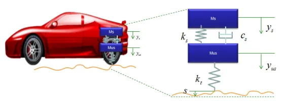

IMO, chassis tuning should be in the following order:
1. Reducing unsprung mass. That means lighter weight wheels (and tires). OEM Stinger 18x8 wheel weighs 30 lbs. G70's 19x8 and 19x8.5 are 34.0 and 34.5 lbs. Our Enkei 18x8.5 are 20lbs each. Less unsprung mass take less spring and damping force to control; less rotational inertia means faster accel/decel. Along with better tires, this mod has far great impact on handling response than any other.
2. Lowering/stiffer springs. These more profound impact on chassis dynamics than just anti-roll bars. They control not only suspension control at each corner independently, they also lessen brake dive and accel squat (pitch axis), as well as cornering lean (roll axis). Typically, lowering springs need to be also stiffer to compensate for the reduced suspension travel. The Eibach are about 10% stiffer both front and rear. To my surprise, I have found that not all brands of Stinger lowering springs are that way.
3. Anti-roll bars. Although their namesake makes their function rather self-explanatory, I added them to both cars primarily to introduce a measure of control to the car's overall cornering attitude. As is, Both Stinger and G70 tend to understeer on corner entry, having adjustments on the anti-roll bar should help tune some of that out.
I'll skip the downside on this go-around. Folks are probably getting tired of my long spiels and digressions. :)
I disagree with the order of the springs, you basically have excessive undamped movement in both directions, which will reduce traction. There's no free lunch, lowering springs mean a stiffer spring rate to keep from bottoming. You will have stiffer suspension, but it will break loose easier too. I see cars all day in autoX leaning all over the place...but not breaking traction. I see stiff cars doing the opposite too. Lowering springs and not adjusting damper rates to match means excessive wheel movement. You won't "see" this very much with the naked eye, as you correctly describe the reduced body roll/squat, etc., but as surfaces are never perfect, the hard you go and push over these irregularities will cause you to break loose earlier, as compared to not messing with spring rates OR also increasing the damping rates. I had a nice setup with my BMW 4 series because I had the electronic shocks and not only could I put them on a stiffer setting, I had an aftermarket Dinan tune for the electronic suspension that made it even stiffer...which in that case did pair well with the ACS lowering springs. IMO, you only put on lowering springs by way of coil-overs or adjusting the damping rates. Otherwise, you really aren't gaining anything and just decreasing the performance. It "seems" more aggressive, but during quick maneuvering and G-limits, you're lowering the traction limit.
Swaybars are a mixed bag. Helping to not transfer excessive weight/cause roll and liftoff from the inside tires is an obvious plus for turning, but stiffening the rear often is at odds with putting power down. I would still 100% add them to this car (like I did), but just realize that they aren't necessarily a sure shot for everyone when racing AutoX. Lot of people simply think they need "these stiffest sways" and that's one that can make you slower if it's too stiff.
And tires and wheels, yep. Get the smallest widest wheels you can with the smallest profile and width tires that normally fit it. For practicality reasons you can't necessarily put 11s with 285s on there, but you want a stiff sidewall, which means you need wider wheels to support a decent width tire.
Some of the "big wheels" trends are just out of control IMO.

I wrote a piece on G70 forum that explain this in more detail: 22 G70 / Stinger AWD Lowering Spring Install Review / Video The key to proper tuning is knowing what changing one parameter affect chassis response overall. It isn't easy and that's what make it a challenge... and fun.
Besides, there isn't a single BEST way to tune a chassis. Different mfrs have different philosophies and methodologies, each with its advantages and drawbacks. No free lunch is right.

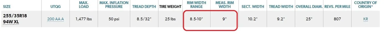

You mean: "within the range for the tire width that the wheel mfr recommends"?
On our AutoX/Track set, I went with 245/40R18 Kumho V730 on TFR 18x8.5, for very similar reasons to what your described. It has worked well this whole last season and we've been quite happy with it. That said, there is always room for trials and experimentation. This set still has enough tread left and will probably do okay this season, but it's obvious they've heat-cycled substantially and no longer as sticky as when they were brand new. On the last AutoX a week ago, the ambient temp was low enough they were slip sliding around a good bit for the first 2 runs. I think they'll do better going into the Summer, but that's about it.
After that, I'm thinking about switching to 255/35R18. Kumho under-rated the width of the 245/40R18. They are frankly as wide as the 255/40R18 A/S tires we have on the G70 now and actually a bit taller. Not uncommon for tire mfrs to do that on their 200 tread wear lines, probably to help skirt SCCA rules.
255/35R18 should help reduce the sidewall height a bit, which will help lower the ride height of the car, without reducing suspension travel. Because these are dedicate track tires, we don't much care if the speed calibration is correct.

The tracks around here are mostly technical tracks without really long straights where you can build speed. The only exception was Texas World Speedway, but they closed. I never like that track anyway, especially on 2 wheels. I doubt I got much above 100mph on the MSR Cresson 3.1mile I ran. Maybe some of the big HP cars did.
I think even Bluestuff might have trouble scrubbing off big speeds like what you described. EBC has several higher classes of pads compounds that might take even higher heat range better, but IMO at some point, you are going to run into thermal capacity limitation of the stock Brembo brake size. Going to larger brakes might be the way to go.
I prefer shorter more technical tracks. Fun, to me, is to be had in the corners. This is especially true on two wheels. If there weren't any twisties, I'd probably sell all my road bikes. Cornering is a finesse sport, and I find lateral Gs far more satisfying than straight line speed. Cost far less too.

Let me try again: "within the range for the tire width that the tire mfr recommends for the wheel rim width you have"?
I think I got it right this time. Like this:
This is, of course, spot on correct... when you are picking tire to fit over an existing wheel.
Depending on which part of the tuning process we are talking about, this decision may not come first. My original post you first replied to was talking about reducing unsprung weight and rotational inertia from an OEM setup. At that point of the game, the first decision should focus on selecting the aftermarket wheel for best fitment, with optimum diameter/width/offset, and to maintain factory scrub radius.
Afterall, wheel selection is where you'll net the most gain on weight savings. For me, that was a whopping 14 to 14.5 lbs per wheel.
Only after that selection is done should you start considering tire choice. There might be an iterative process that goes back and forth a bit, but tire choice is a secondary consideration after wheel selection.
Yeah, although I weighed my 18x8.5 enkies and OEM 18x8s and the difference wasnt dramatic, with tires mounted about 5lbs lighter per, not bad considering its a wider tire than OEM. Also lighter due to no run flat BS, so not really much weight saved in the rim. Probably a few lbs and a combo of both the tires and the rim.
