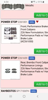

any pad that fits the Cadillac ATS V6 with Brembo front brakes 2016 and newer will also fit the Stinger front Brembo brakes
Also looks like the Cadillac CTS Brembo fronts have the same pads. Someone else please verify
