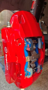

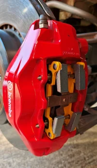

2019 Stinger GT2, Having a hard time finding in stock Posi-Quiet Pads. Anyone have advice or links to best current OEM alternative for similar OEM performance without the deposits issue? Also looking for a good alternative for Rear rotors, but will buy the brembos if I have to. Thanks!
I have been using these for about 10k KMs. Perfectly silent, and smooth so far.
Also they are very economical
Also - relevant link
OEM rotors are good ones. It's the pads that you want to shop around for. Most aftermarket pads have been reported on here to fix the vibration from pad deposits.
Hell yea, Just ordered the rear rotors off of Brembo's amazon store for only 108.77 per rotor
