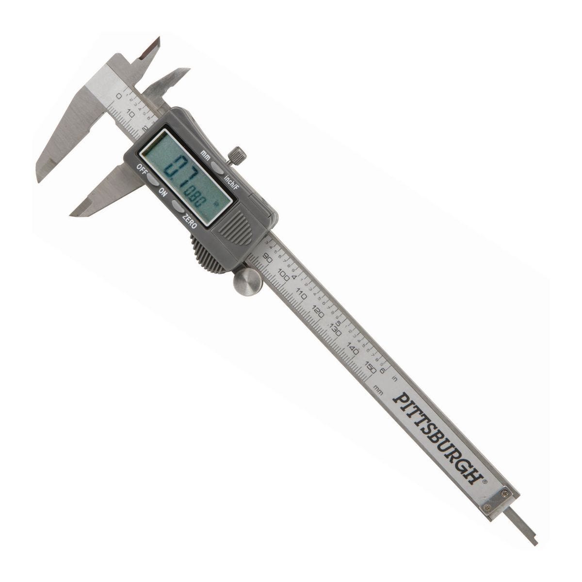

$19.99 will tell you right quick if you might need new rotors. 6 in. Digital Caliper with SAE and Metric Fractional Readings
Rotor service thickness limit here: https://www.kstinger.com/disc_brakes_and_pads-351.html
There are a few other considerations, but above is a main one. Unless your rotors are anywhere near the service limit, resurfacing works just fine and even have some advantages over brand new ones.

Mine were:
Measured 29.85mm before
Measured 29.25mm after
Speak is nominal = 30.0mm
Service limit = 28.4mm

Brake rotors are very hard, and very long-wearing. I can't imagine taking any serious amount of material off of them in 10-11k miles, but I guess it's possible they were very aggressive when they turned them. You should be able to take reasonable measurements with a cheap pair of calipers (I'd do a handful of points around the diameter) and compare to the spec @D.J. posted above.
