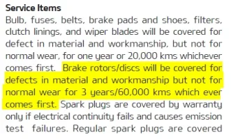

Canada is 60k kms on brake rotors/disks.
That's what I thought I had read a while back on here; but I went looking before I posted and saw this: Kia Warranty Program | Kia Insurance | Kia Canada
"1-year/20,000 km - First-year adjustments covering consumable items such as bulbs, wiper blades, fuses, brake pads, etc.*"
So, I assumed it had either changed or I got it wrong. The link to the 2020 manual shows what you posted. Now, the question is, does Aus have the shorter or the longer warranty? The US warranty manual doesn't mention "rotors/discs" at all:
"Brake linings, including pads and shoes, and clutch linings are warranted for 12 months/12,000 miles, whichever comes first, if they fail to function properly during normal use."
Despite some passionate feelings on this, the manufacturer doesn't consider it to be a defect in material or workmanship.
