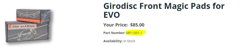

Hey guys are these the right giro disc ones? MP-1001-1 (note the -1 at the end)
Getting really tired of the stock issues 2nd time around for me. Cheers
