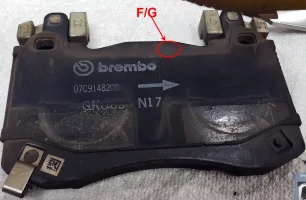

I checked my pads and they are FG rated ( I believe EU is rated GG and are semi metallic) which means they are ceramic, same as USA, and yes I have the brake shudder issue alsoJust curious - I've seen the Euro pads mentioned here, and some have gone that route. Are they the same as the Australian pads, or different yet again? What about KDM spec pads?

Which PN of Centric pads are you using?No, the rotors are not warped. The pads Kia used "melt" and leave material deposit build-up on the rotor surface. The bedding procedure removes those deposits.
A higher quality ceramic pad will not leave the material deposits. I am using Centric Posi-Quiet ceramic pads and flawless performance.

Dealership offered to cut my rotors with about 13k miles as a "courtesy". Of course their diagnosis is warped rotors. They said they could install my Stoptech pads for $25 but can't warranty anything. I figured that would be better than just cutting the rotors and putting the same OEM pads back on.Replacing rotors is a temporary fix without different pads.
