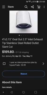

Could anyone advise me if these tips would work with a Borla S Type exhaust? 4"x3.15" Oval Out 2.5" Inlet Exhaust Tip.
Looking to have them physically attached to the exhaust via welding or clamps to help prevent drone.
I'll be having a custom exhaust shop install everything, so maybe the question is, should they be able to make them work?

I don't have a Borla but from what I see, the exhaust pipe diameter is 2.25 rather than 2.5 inches. If that's accurate, you'd be better off looking for a 2.25" inlet for the tips. I have the MBRP exhaust and that one has a 2.5" outlet so that's the inlet diameter of the tips I got.

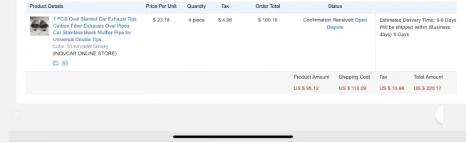

not to mention that price is nuts. I paid about $108 for all 4, shipped, for identical stainless tips. do not pay $150+shipping each.
That price was for 4 actually. But you're definitely not wrong lol
Thank you, I'm checking them out now. Shipping to usa seems a little crazy though.
Check the various shipping options. If memory serves, there was two options. DHL option was like half the cost of the other one. maybe $50.?
I paid extra cause I didn’t want to wait forever for the tips, dhl. Lol

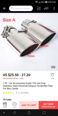

Per the recommendation in this thread, I think around pg 50-52, I bought these from aliexpress for my Borla. They are on the way to me now.
You're supposed to get 51mm inlet, size A

Yep. No cutting required. I will say the exhaust mechanic had to stretch them
Slightly to get them to slide over the Borla pipes. They had the tool to do it though. They fit through the bumper just fine.
