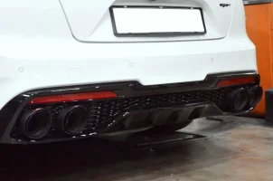

Hey y'all, just figured I would follow up here. Looks like mine is a similar setup to Buklau. The tips definitely stick out a bit more than stock, but this could be adjusted to sit further in.

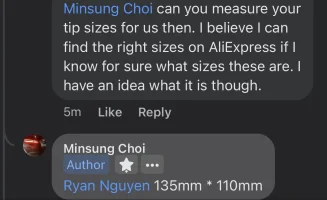

I’m looking for the correct size for stock exhaust. Is 54 IN, Size C Out the right size?
Also, is there any empty space between the tips and the Diffuser?

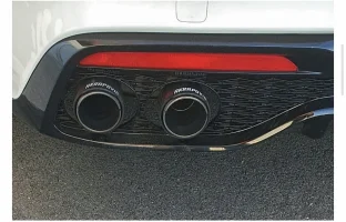

Can someone please confirm if MBRP CF exhaust tips with 130mm (5 inch) is too big for 2023 GT2? Or is 4.5 inch (115 mm) a better fit? Thank you in advance
