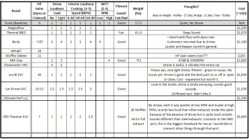

    I trust you about the 56lbs!
    10lbs box? that sounds like a lot! :confused:
    but anyway, I will find out the truth and update my findings. Thanks for pointing this out!

    3,455
    1,349
    I just checked my shipping info from FedEx for my Thermal Exhaust. They weighed the package 74lbs. I weighed the exhaust without the box at 61.4lbs.
    Those big boxes are heavier than they seem.
    Let us know what you find out.

    I am looking at all posts from aftermarket shops and everyone claims either
    - 50% weight reduction vs. stock
    - 20kg(44lbs) weight reduction vs. stock
    Someone is not telling the truth. :devil:

    Ark saved 4.5 lbs over stock. Mufflers lighter, mid pipe slightly heavier.

    Latest Update: upload_2018-10-1_7-15-32.png

    Was thinking about Borla, might pull the trigger if somebody can confirm that it actually frees up some HP. Can anyone confirm?

    Also, any boost with Magnaflow?

    My butt Dyno seems to think the Borla is could for at least 20hp....LOL

    Yes, I would really like to know about Magnaflow also.
